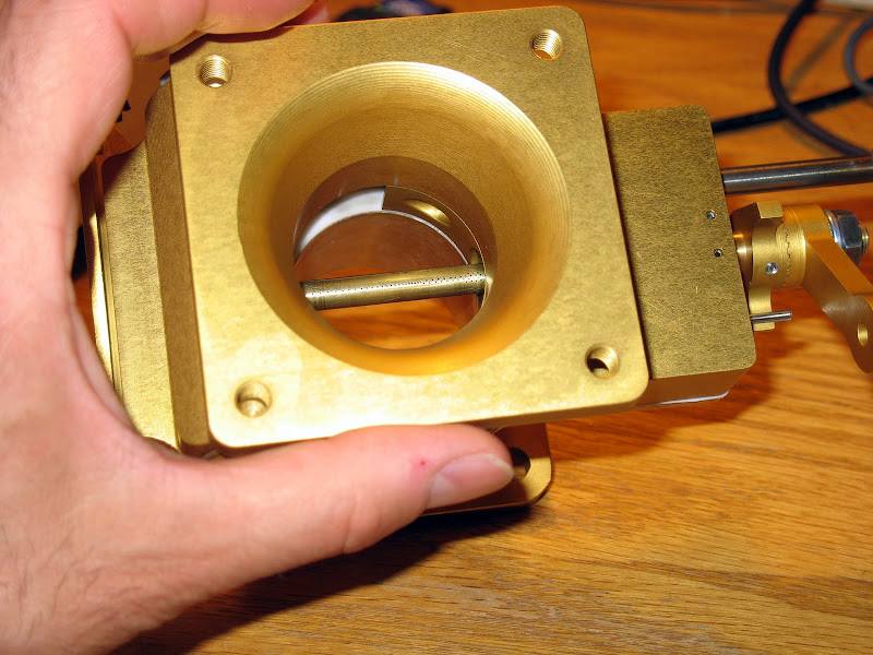

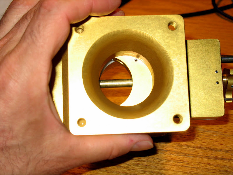

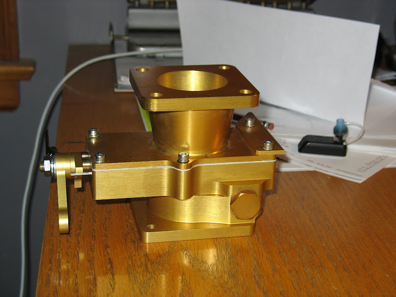

I am working out the installation details now. Hangar-mate supreme Alex P engineered an adaptor to match the height of the Rotec TBI to the carb, allowing use of the same airbox. it was machined this week. Cable rework will come next.
The unit is a gem to look at. Nice machining with Viton seals to allow use with Mogas. Intro price of less than $600.
Some photos of the Rotec unit.
Metering Holes produce "Fuel Fog"
Partial Throttle
I have a great data baseline for my carb, including extensive LOP ops. We will be measuring the performance of the TBI carefully and with great interest.
