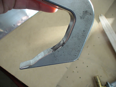

Default 60 Degree Rivet Set
I've tried at least half-a-dozen ways of riveting in tight spaces and by far the easiest and best results (for me) is backriveting with my modified 60 degree rivet set. The only thing I have to be careful of is keeping the bottom of the set parallel with the back rivet plate so the heel of the set doesn't ding my back rivet plate.
I modified this one on my grinder. Got it off that giant auction site for $2 + $5 shipping!

Old 08-02-2009, 05:47 AM
pierre smith's Avatar
Location: Louisville, Ga
Posts: 7,840
Default Vice grips' jaws...
...can also be ground down smooth and the thickness of the jaw that goes into the tight place ground down. Then you simply squeeze the rivet.
