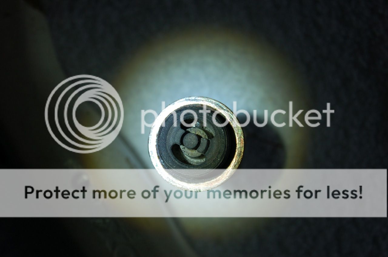

Default 1,100 hours on iridium-s plugs
bought these plugs in hope of reaching tbo with them. there dosent seem to be any wear yet. no maintenance done. a few lead balls on the lower plugs. easy to clean. i rotate them at the annual inspection.

Which ones do you have? I have 700 hours on a set of the Auto Light Iridium plugs; I only clean them at annual, about 250 hours each year.

Out of interest, what do you clean them with?..I see harbor freight have spark plug cleaning shot blaster thing but I have no idea if it works as it should?

these are champions which only need the lead balls scrapped out with a dentist pick. usually on the bottom plugs.

I is not recommended to use abasives such as this; too harsh.

amazing...little appearance of any effect at that many hours!
...gee I thought they all had 2 wires!....I guess the wear would be half as much on a 2-wire? Mine are Autolite I think?..but only 50 hrs. or so on them, so nothing to report.
