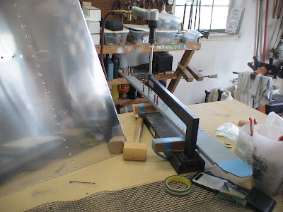

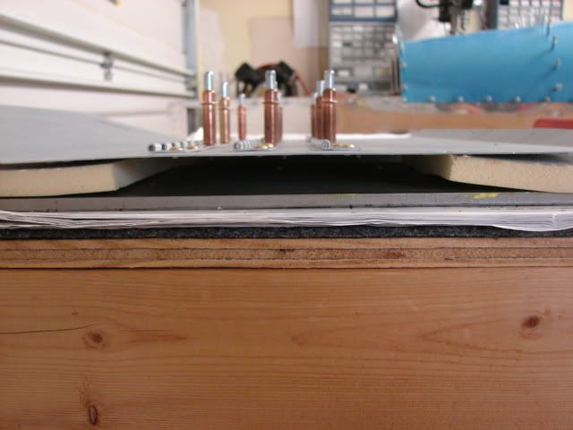

Here's an idea that hit me as I was trying to figure out how I could rivet some 470 rivets without any help. I'm wondering if somone else has already talked about this.
After getting the hinge parts ready to rivet onto the floor of the RV, I was going to have to figure out a way to set the rivets without any help or wait until I did get help.
So here's what I tried - and it worked......
Using one my my backriveting plates, I placed a small, thin (about 3/8") piece of foam rubber on each side of the riveting area. Then, making sure that no clecos were clear of the plate so they wouldn't interfere, I used my 3X gun to set the rivets using the backriveting plate as my bucking bar.
Here are the pix....
There's no way this method could be used in all situations but it sure worked great right here.

I can't see the pics, my employer blocks them. But I think I understood your situation. I believe I used my c-frame for that task. I ordered one of the AVery kits, and part of it included a direct rivet-gun rod for use in the C-Frame. That piece is for the shop head side. I placed the unversal head into the C-Frame base. It is then a delicate balancing act to start riveting. It was not overly complicated though, and things came out well.
The only concern I would have with your solution is ensuring the work pieces remain flush against the manufactured head when you start riveting.

I'm not really understanding how this works. Since I may be doing quite a bit of riveting on my own, I'd like to. On which side of the assembly is the shop head? Does the plate bend down to the back riveting plate?
I had the same thought. I suppose you could always rivet against a squeezer yoke slid in between the part/rivet and backriveting plate to reduce the bending.

It looks to me like it isn't really back riveting. From the pics it looks like universal set is used in the gun and the shop head is formed on the barckriveting plate (it is just acting as a bucking bar). I suspect that the foam compresses and the assembly being riveted flexes downward slightly to close the gap. It looks like something I'll have to try out.
mark
