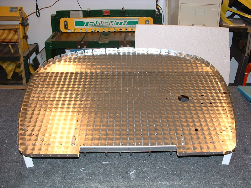

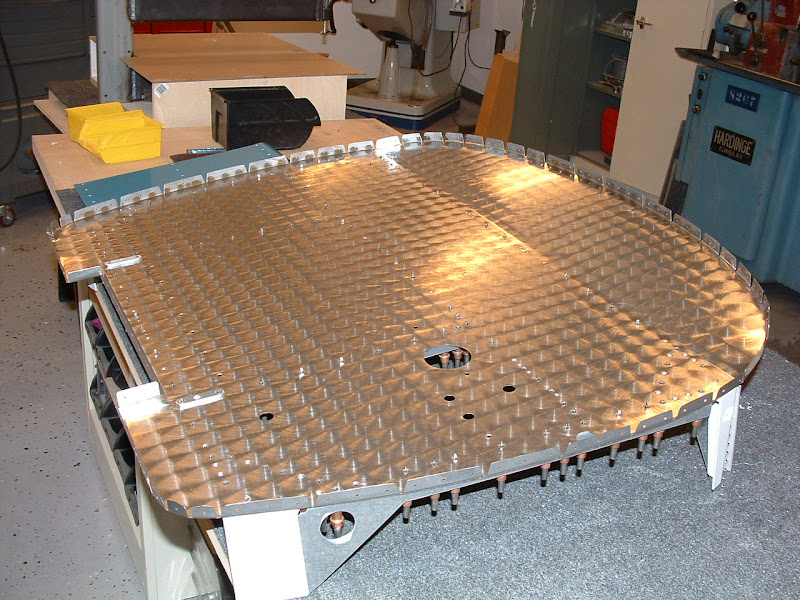

Old 07-10-2009, 11:54 AM
CMW CMW is offline
Join Date: Mar 2007
Location: Livermore, CA
Posts: 167
Default Engine Turning
Here's another example of engine turning on my firewall. To do this, I laid out a 1" x 1" grid with a sharpie on the firewall and then used a 2" diameter Roloc scotchbrite wheel in a cordless drill. Took a while and I'm not sure it's worth the effort but it looks nice now.
Chris
