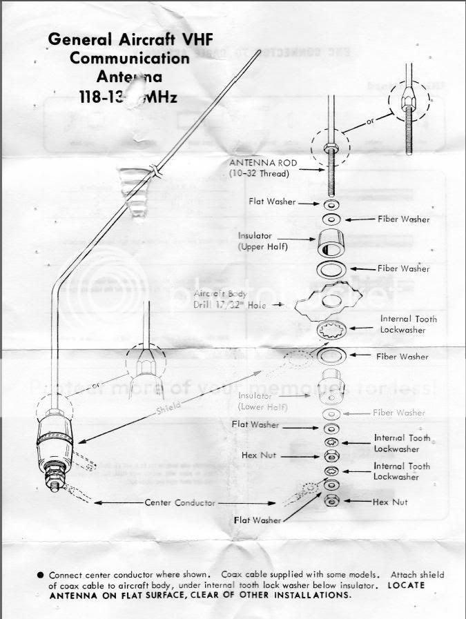

However, grounding to the fuselage skin at the antenna base is important. Make sure that the paint/primer is scraped off and fresh star washers - or whatever the antenna manufacture specifies - are used.
Your experiment showed the critical nature of this RF ground at the antenna location....
Here is my set up - #2 nav/comm is a KX155 Nav/Com feeding a plain rod antenna mounted centerline bottom, #1 com is a Garmin GNS300XL GPS/COM feeding a rod antenna mounted on turtle deck. RG400 coax with BNC connection at radios, center conductor connected to antenna via ring connector at antenna with shielding grounded to airframe near antenna via ring connector (ala B Nuckolls). All connections on #2 were checked solid.
How short is this ground pigtail at the rod antenna? The exposed center conductor portion and ground pigtail should both be as short as possible.
I don't understand this bit shielding grounded to airframe near antenna via ring connector
The ring connector usually is the grounding point at the hole that the rod antenna passes through.
Typical instructions are here -
http://i644.photobucket.com/albums/u...la/antenna.jpg

Thanks again Paige and Gil. You are right Paige, the KX155 has a higher wattage output than the 300XL. I suspect that it is just overpowering the relatively poor connection (no BNC) at the antenna. This antenna is also much closer to the EIS than the 300XL antenna connection. That all makes sense. (By the way, I always get the Tx light in the KX155, just no side tone and no apparent transmission).
And I see now that it isnt really a ground loop issue. Just poor conduction of the RF energy from the coax to the antenna. Thanks for the drawing Gil. My shield ground is located right next to the antenna but is not concentric to the rod.
It all sounds like this can be overcome by springing for a real antenna connected via a BNC. (As has been suggested in other threads on the subject). The rod and loop connecter may get by on lower power radios, like it almost does with my 300XL, but the higher power KX needs a more efficient conductor. I'm convinced.

Question How long are the...
...exposed portions of the shield and center conductor?
How close is "right next"...
These dimensions should be at an absolute minimum.
