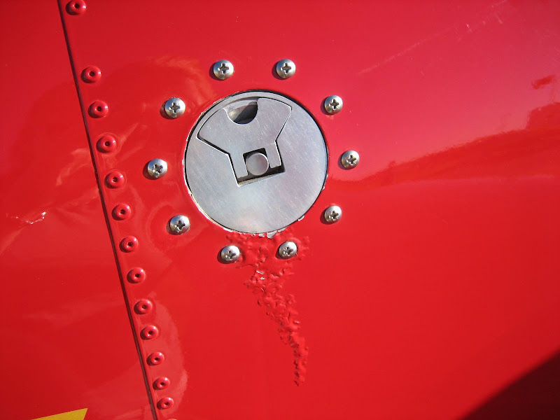

The paint around the fuel cap Was this happening because of the type of paint?

It's what happens when someone totally tops off the tank (and filler tube) on a cold winter day. Then pulls the airplane into a warm shop where it sits unattended for a long holiday weekend. Cold auto fuel (with ethanol) expands in warmth of shop and dribbles out cap vent keeping the paint wetted non stop for three days.
A very difficult test for any paint...It has since been repaired and has not reoccured.

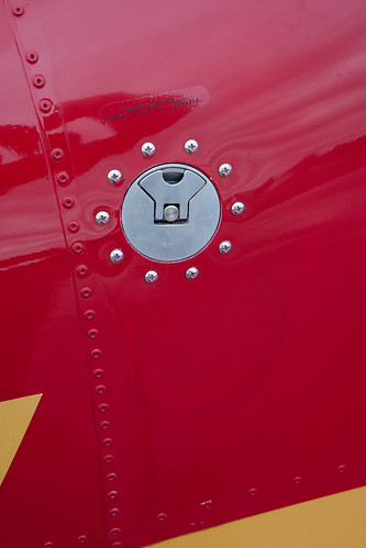

Is the fuel cap supposed to show the fuel type and quantity?
Scott,
Have they been regularly using ethanol-laced autogas in the red plane or a combo with 100LL? Any noticeable effect on the Rotax?

Just got back from the flight (loved it and will post a report in a seperate thread tonight with pictures and such). They are just using multiple 5-gallon gas cans to keep the -12 full of Mogas. All of Oregon gas is mandated to be E10, so I'm sure it has been running it. Rotax has approved the 912 for E10, so it should be alright...
