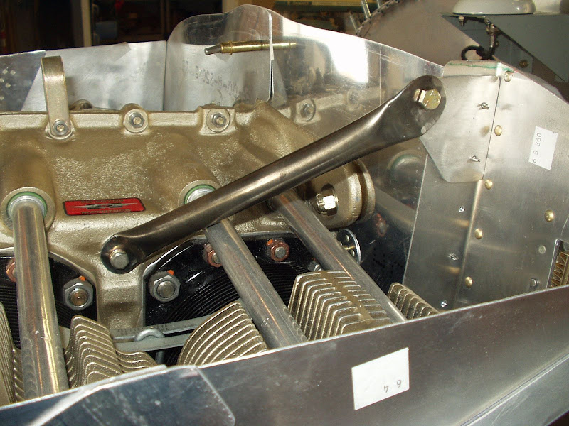

That's a very nice looking installation Mark - very neat. I also am a believer in the diagonal brace, but I ran it from the same corner on the rear baffle to a boss on the crankcase Between the front and rear cylinder pushrods). My reasoning was that the cylinder heads might move ever so slightly relative to the rear of the engine, wereas the spine of the case and the rear baffle should form a pretty much rigid triangle. 920 hours - no cracks!
I also, of course, reinforced the heck out of the left rear corner and cooler mount. I spent a lot of time chasing baffle cracks in my old Grumman baffles, and vowed that I'd carry an extra half-pound on the RV if I had to in order to stop THAT madness!

Mark,
I have to agree with Paul on this one, you don't want to tie the two cylinders together because they do move independent of each other.
Here's how I solved the problem:
240 hours and not a crack in sight.

Paul,
Thanks for the kind words. I remember looking at that boss between the cylinders and for some reason I didn't go that route. Maybe you can post a photo of your brace sometime to show us how it's done. It does sound better.

Old 06-08-2009, 07:37 PM
Ironflight's Avatar
VAF Moderator / Line Boy
Location: Dayton, NV
Posts: 12,247
Originally Posted by Mark Burns View Post
Paul,
Mark
Well, I wouldn't say it's "how it's done"....but here's how I did it!
Paul
