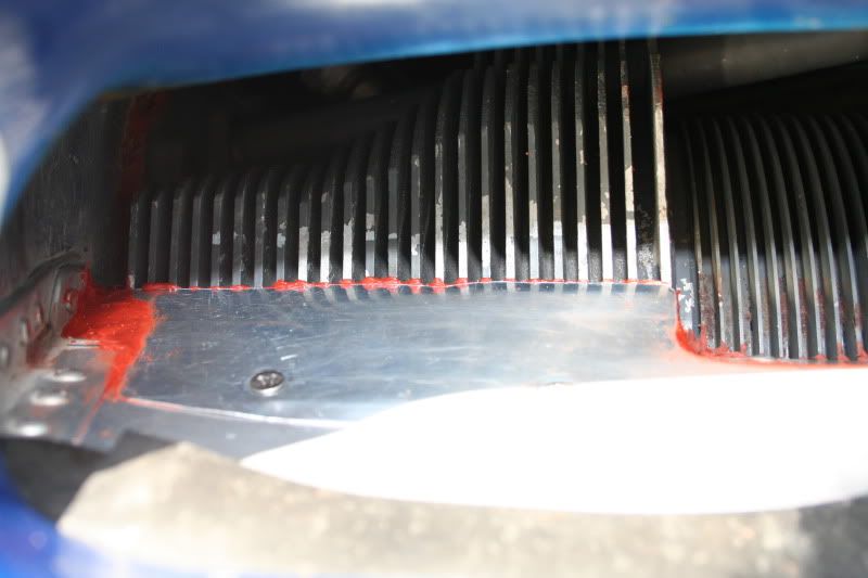

Since new five years ago my Cylinder #1 has been considerably lower than the others (usually under 300 F) and it has been mentioned here that the temperature needs to be brought up to around 350 F for "best" performance. I'm flying in a race at Courtland in one week (6-13-09) and my competition is getting faster and faster so I'm getting desparate. I added three platenuts to the right side cooling air inlet ramp and I made a small deflector to mount there. I will get a test flown as soon as possible. Using my standard test method the speed will have to be greater than 184.4 kts TAS to convince me it makes any difference. We will see. I will report my results but there isn't time for the range of experiments with the deflector shapes and sizes before the race. The one I have now is in front of the large cooling fins at the "top" (outboard end) of the cylinder only. The inboard end is 0.7" above the sck ramp position and the outboard end is 0.4". I just threw in on and measured it tonight. I will work with it a little before I install for flight.

I got the deflector cleaned up, installed and sealed this morning then I went to a rose society meeting with my wife and now I'm back home. As soon as we finish dinner I'm going back to the airport. I don't know haw much time I will have but I hate to compromise the test validity. I have to safety wire two hinge pins and close an access cover which are simple but then I have to remove the wheel fairings to install the subfairings before the plane is race ready. At that point it will be in its fastest known configuration except for the addition of the deflector. I do not expect any gain and I do not have the instrumentation for some of the excelent suggestions here but I will fly the test (weather permitting) record the numbers and report the results. I have 4 cylinder digital EGT and CHT but not fuel flow. Mixture is a pretty gross operation that I need to look at more but in many races now I see no change in speed with subtle changes in mixture. My engine is an Airmotive Carbureted Lycoming O-360-A1A. Comments by Larry Vetterman and Mark Frederick on this temperature target and the tapered cylinder function are driving my thinking a lot. Soon I will know something ...

It was very gusty with speeds at 20 second intervals on the three tracks varying as much as 5 kts. The SL-60 couldn't get a fix at first and I had to recycle the power and reinitialize it in flight. The sun was getting low but I figured I could get the three tracks in and get back to Drake Field before dark in my unlit racing configuration RV-6A. And so I did but the results were disappointing with a NTPS computed TAS of 178.6 kts at 6,000 ft density altitude. The CHTs were 1=312, 2=332, 3=347, 4=329 F. EGTs were 1=1286, 2=1330, 3=1348, 4=1332. I played with the mixture but in the normal operating range down to the 1100s F EGT on CYl #4 but there was no obvious direct speed response. It was only after I was setting here typing that I realized I never advanced to prop from 2450 rpm during the flight so it was a wasted effort. Will try again when time and weather permits. If there is no gain in speed I'll pull the deflector for the race in Courtland Alabama on June 13 and work with it again later.

Default Photo of Ceflector
Bad photo but it gives a view of the installed initial deflector.
