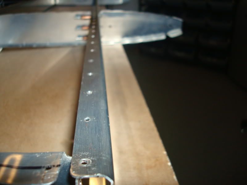

I took a few days off and I?m coming back to it this weekend. I am going to post photos of the items I?m not happy with, let me know what you think. I work to a high standard but seem to be off beat on this, my plan is to shell out for $300 or so in new parts and slow way down. I never built a plane before
First picture is a terable looking HS-609pp radius, one on the right is accepable but the one on the left is bad.

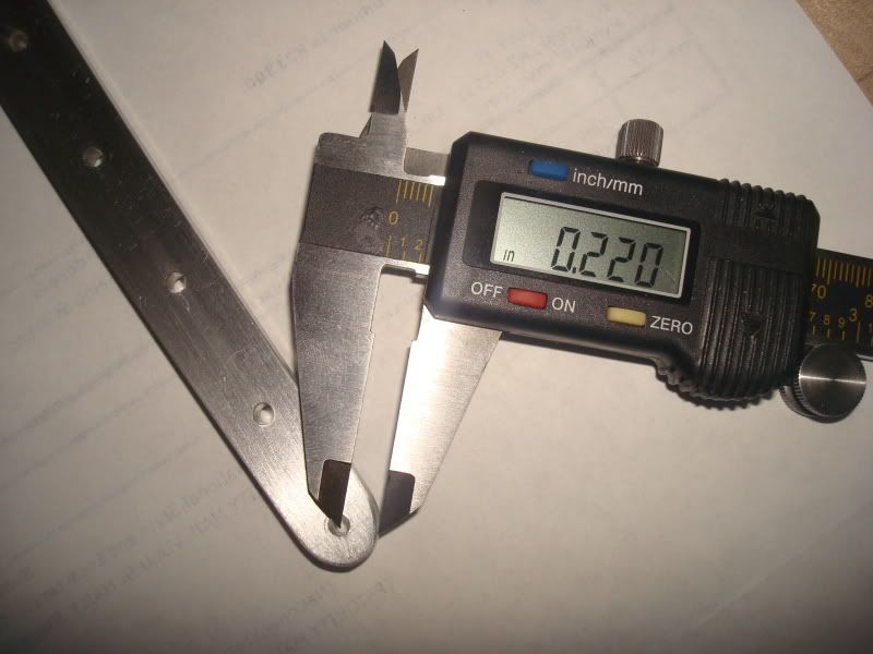

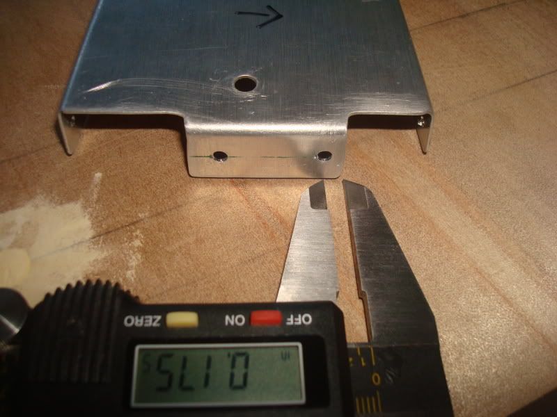

Next is edge distance on HS-404, which screwed up HS-405 & HS-702 as well.

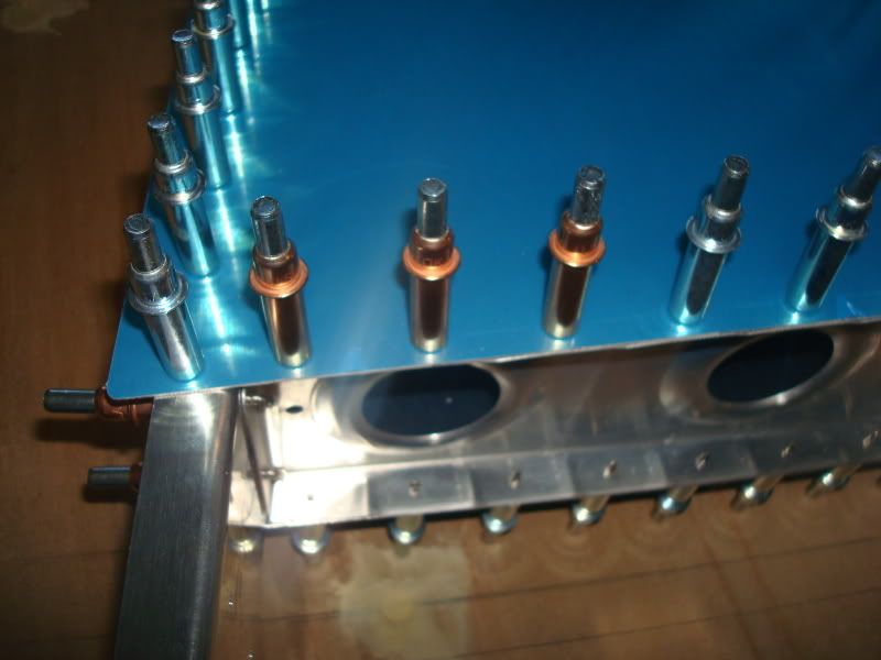

Then I belive on of the ribs to be too long or short as I couldn't get HS-405 tucked into HS-702 far enough. This caused issues with edge distance as well as the rivet line being off center.

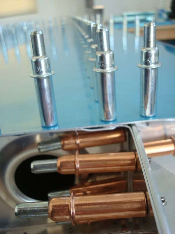

Then to top it all off, I was match drilling the skin to relise "oh s@#$" I just put 3 #30 holes in a skin.....

Breath, have a beer and realize that most of us have gone through this. That being said most of what you pointed out I would say move on, there is no need to replace it all. you can use opps rivets for the three #30 holes you drilled (or just use a #4 flush rivet in those holes).. If you try and make everything perfect you will never have an airplane.

In a nutshell, you are being WAY to hard on yourself here. None of the examples you illustrated with pictures warrant replacement or sleepless nights.
From what I see, you are building at or above the standard of care, which will result in an airplane that you will be proud of and which will be safe. Remember, building an experimental airplane is an educational experience and you have already learned volumes from what you perceive as mistakes.

If you are building for show, I think the choice is obvious. If you are building to fly, this stuff can be fixed. Your HS 609PP Looks alright to me, getting close on the edge distance but still within tolerance. Put some AD426 4-4 in the 3 holes you misdrilled. I think doublers could be manufactured to fix your other edge distance problems. If it will make you feel better to replace it, then do that. Starting out is tough, especially when you don't have much in the way of aircraft construction knowledge. Get involved in a local eaa chapter if you can, this will help down the road as there are lots of people around to lend a helping hand. BTW, if you look at some of the tails that are on flying RV's, you will notice many people go through this. Enjoy the build.

While you can use a NAS 1097 "oops" rivet to cover up the occasional mistake, using 3 in a row is a no no. You are not supposed to use them when they are next to each other or close together. The rule of thumb is only 1 rivet in 10 can be a NAS 1097 rivet. Otherwise, strength is compromised. Since you have 3 in a row, just dimple and install 1/8" rivets.
I had a fair amount of difficulty driving the 1/8" universal rivets in my HS skeleton. I've got at least half a dozen 5/32" rivets in my skeleton. Only replace that skin and rib if you will be bothered by the cosmetics issue.
