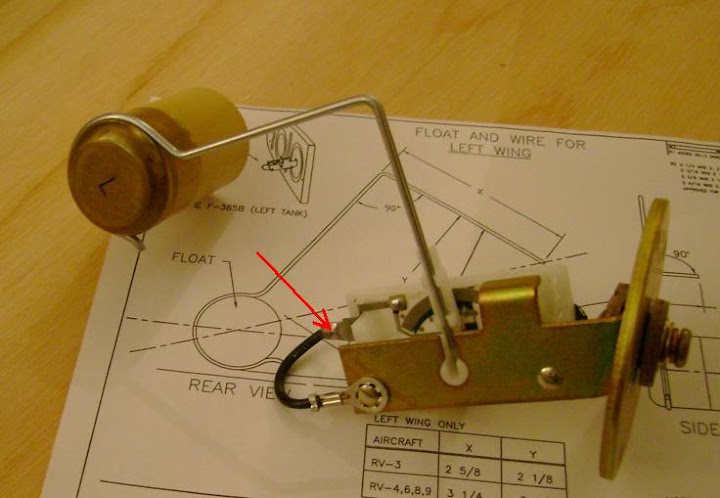

I have been having intermittent problems with one of my float fuel senders.
Last week I decided enough is enough, pulled it out and found a cold solder on the ground wire, see below:
http://picasaweb.google.com/lh/photo...eat=directlink
I replaced it with a new sender, but the lesson here is to inspect the solder connections before installing.

IF THE CENTER TURNED WHEN U TIGHTEN IT U BROKED THE WIRE U HAVE TO RE SOLDER IT CHECK MIT OUT IT DIDENT LOOK LIKE IT WAS BROKEN DANNY
