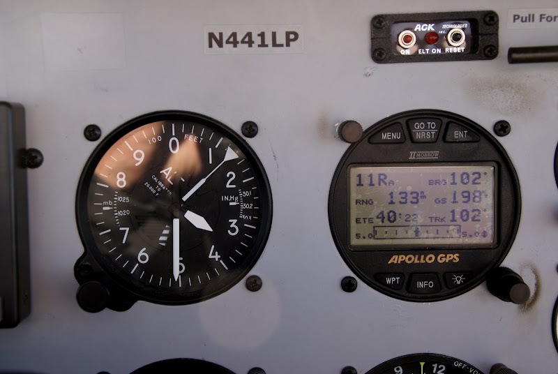

I wanted to have lunch in Brenham, Texas, yesterday (4/19/09), for Louise House's birthday. That leg is 424 nautical miles and there was a real good tailwind, increasing with altitude. In this situation, a lot of people would choose to go high, an option we have. I did so, and averaged 185 knots (212 MPH) block to block with a really low fuel burn. That was a really quick and easy leg.

The rule of thumb about slowing down when the wind is with you would assume that you don't want to make maximum speed and that economy is important on that trip. It can be fun to see the MPG over the ground figures on those kind of trips, but if you are in a hurry you would fly at the maximum power you are comfortable with, no matter what the wind, oh but range may be a factor also and then there is the altitude question. Usually winds increase with altitude but available power decreases (normally aspirated) so you have to look at the variables for the particular trip you are making. It hasn't happened to me that often, but sometimes it is worth it to climb up around 18,000 feet to get good speeds at a very low fuel burn. This usually takes a long leg to be worth it and it also means dealing with oxygen.
I believe I was getting about 40 statute miles per gallon (at 237 MPH) when the above photo was taken.
