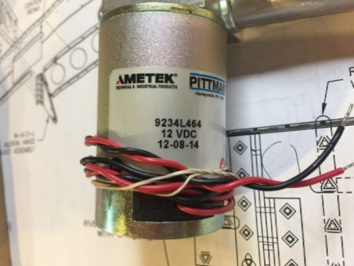

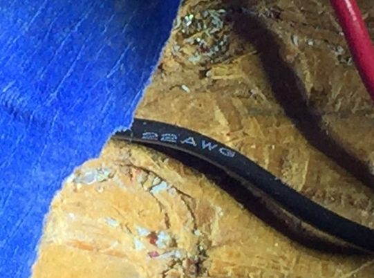

Just looked at the pigtail on my ca 2015 motor and they are marked awg 22
are you sure?
22 is only good for max of 7 amps.
bob burns

double checked..
RV8
My OP-10 shows AWG 18 to the motor from the switch, but the circuit is protected by a 5 A fuse, which is my plan.

Flap motors draw a bit over 5 amps when heavily loaded. I used a 7.5 breaker and have had no problems. 22 AWG is fine for 7 amps, especially for a 1 foot wire. I think I used 20 gauge. 18 is overkill for a 10' run at 7 amps. Either way, size the breaker for rating of your wire, not your device.
