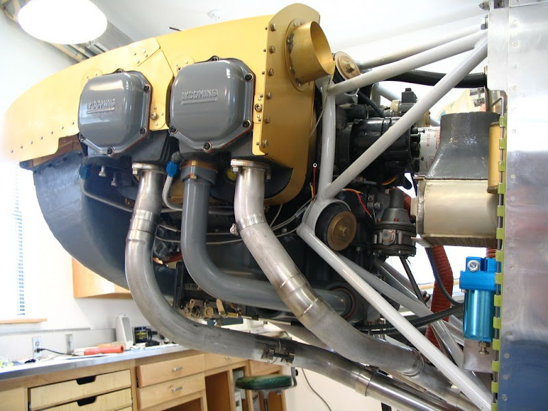

Charlie refers to the RV8A, here but I wanted to show how the IO360C sump fits up on an RV8:
One thing to take note of: This IO sump is mated to an "O" top end. So, the intake pipes required special 1/4" adapters to fit up. They're visible right where each intake pipe bolts to the cylinder. We can make those too. The left front intake pipe is missing; I finally gave up on finding a good used one and ordered a new one for $330 bucks. Ouch.
But, its a neat installatioin. Really compact, smaller vertical profile, nice clean cowling, simple and direct control runs. We'll see how it runs shortly...

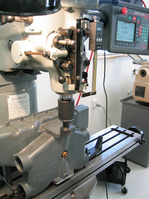

Machining off the frontal sump casting boss: A standard knee mill does just fine for this job. CNC not required, although I prefer it. Here's how I jigged up my sump to do the work:
Facing off the casting boss:
After that, we just drilled and tapped for studs.
By the way, if anyone needs a forward facing sump, I have one on the shelf here. Its off an O360 A1A; was updraft now its set up for forward facing injection. All work done by a certified shop, really nice work.
