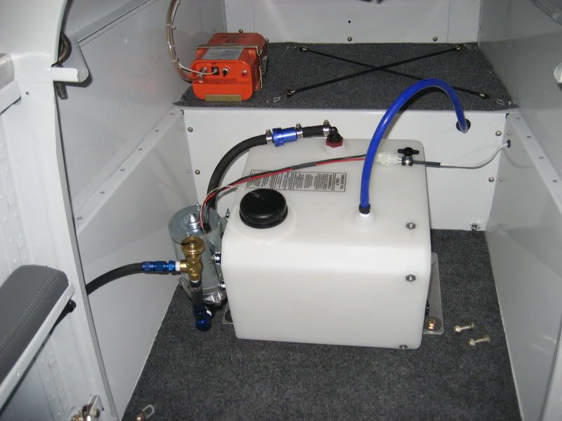

Hi Allen
Unable to directly help you as you have a battery in the rear so I post this to help others. I was the "someone in the UK" Andy referred to in his previous post and I have taken his advice for the reasons he listed.
I am awaiting modifiaction approval from the UK auhtority of a tank that I plan to attach to a modified rear battery tray. This will be custom made along the same design as the wing tank and will have an access door on the right fuselage skin to reach the quick connect fitting for filling/draining it will also serve as an inspection port for the tank & pitch servo.
I will buy the "everything but the tank" kit from Smoking Airplanes and John has been most helpful with any inquiries - the kit also appears to be very professional in every sense.
If I use the tank as a ballast for aerobatic competitions (no smoke) then if I need to carry a rear seater my plan will be to pump the contents of the tank to the exhaust, or drain, and collect in a plastic container that will fit into the forward baggage bay.
I chose the rear battery location because it is a strong point and will not compromise baggage space or contaminate the baggage bay. It will hold about 12-13 litres - enough for about 4 mins smoke which should be OK.

Originally Posted by N24YW View Post
A fellow builder made this tank for me. It holds a little over 2 gallons.
Two gallons of oil, an aluminum tank, and no firesleeve...all firewall forward.......hmmmm...
