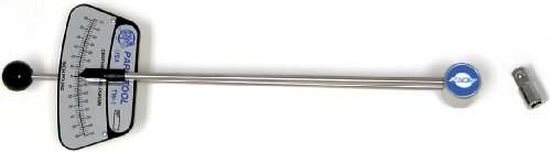

Hi guys, when torqueing a AN3 bolt (25inch pounds) I've noticed it takes almost that to overcome the resistance of a locknut. So do i add another 25 inlbs when the nut bottoms out.

In my experience, the run-on torgue for an AN3 locknut is only about 7-in# or less in most cases. If you're adding 25in# to the initial 25 in# on your torque wrench I'd have to wonder whether or not you are severely over-torquing them. If you're unsure, a dial or beam torque wrench is the only way to know for sure how much run-on you need to add to the standard 20-25 in# specs.

AC 43.13-1b (aka "the Bible") is now quite clear on this.
d. Add the friction drag torque to the
desired torque. This is referred to as “final
torque,” which should register on the indicator
or setting for a snap-over type torque wrench.
A copy of the hardware section is on the FAA web site at this link.
The entire AC is here.
Earlier versions of the AC were not quite as clear on the subject.
As Steve said above, while I was writing, the task is much easier with a beam type torque wrench, like this Park TW-1 -

..the beam type torque wrenches.
They are much harder to get out of calibration. You would essentially have to change the temper of the beam to cause a major change in calibration.
The "click" types have a lot more internal moving parts that have to work correctly to stay calibrated....
