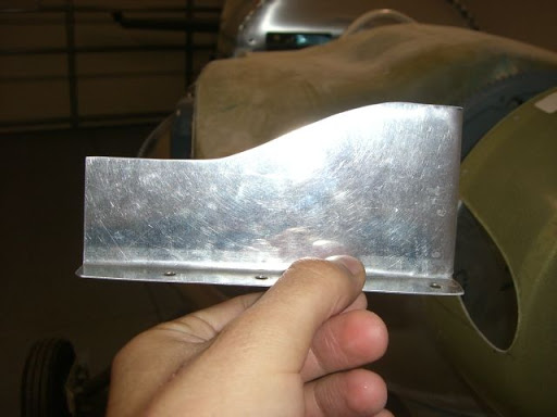

You probably already know this, but don't forget to put air dams on the front of cylinders #1 & #2.
Lookin' good!

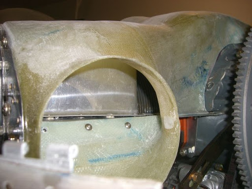

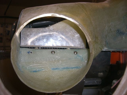

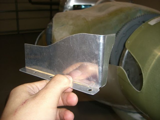

This one goes infront of the #1. It is attached via number 8 screws. The pictures below show the dam not attached just on top of the screw.

I presume the deflector plate is to prevent overcooling the front cylinders and to direct air to the rears?
I have not noticed this before in any of the photos of Sam James system, and as I am doing a similar arrangement on my 4 would be grateful for the advice.

Originally Posted by WAM120RV View Post
Hi AX O
The plates are used in order to keep the temps on all cylinders as close to each other as possible.

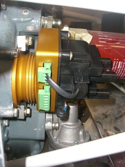

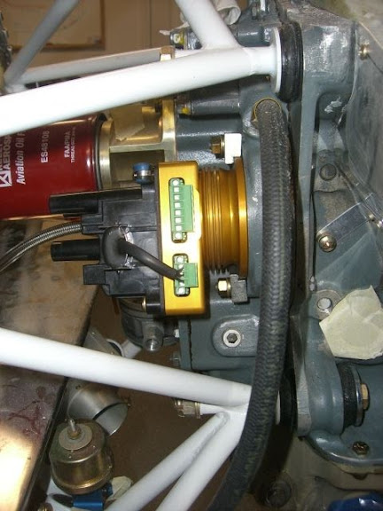

Looking good. Kinda disappointed (and slightly scared) that you decided to you with the dual p-mag route. I don't trust dual EI as a general rule.
It's a shame you don't know anything about the P-mags other than what you read on the internet to make such an ill informed comment.
Now back to Axel's build progress. Looking good. You will really enjoy those P-mags!

Put both of my Pmags on today. Like always, nothing is easy for me I dropped a bolt, washer, lock washer and securing tab inside the hole for the mag. I had to take the oil pan off in order to remove the FOD from inside the engine. Oh well, que sera sera.
