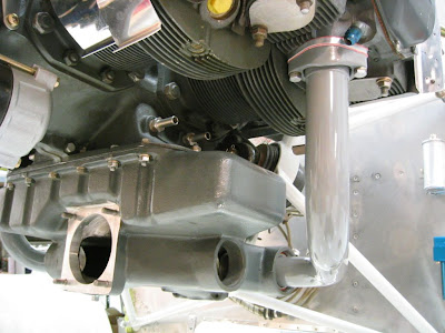

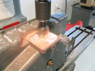

Machining the IO sump for frontal induction
We fitted an "IO"sump to an "O" top end. This required using IO360C intake pipes with a .250" thick adapter at the cylinder attach point. We liked the IO sump because of its smaller vertical profile, pseudo cold air induction, and frontal intake config.
"IO" sump fitted to "O" top end. Note intake pipe adapter.

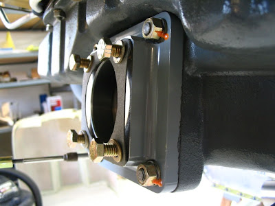

The next trick was to design and fab an adapter to mate the RSA-5 throttle body to the sump.
Throttle body adapter

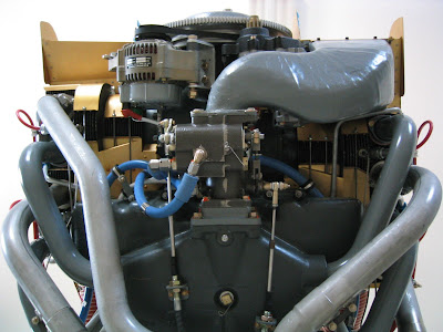

Now a fiberglass S-duct was designed. Although it looks sort of crooked, it actually has a linear reduction in cross sectional area from inlet to nozzle. The duct also looks clean from the top because we hid almost all the attach hardware underneath the baffle floor.
Intake duct

Old 02-04-2009, 09:01 AM
Bill Wightman's Avatar
Bill Wightman Bill Wightman is offline
Join Date: Aug 2005
Location: OKC, OK
Posts: 687
Dan, I was wanting to avoid rapid changes in pressure inside the duct. As we shaped the foam around the starter, it turned out that was also close to where we had minimum lower cowl clearance. The duct cross section thus began to get too small in that area, and the next thing the flow would encounter would the the 90 degree bend into the throttle body.
So, I decided to take a closer look at the duct's cross sectional area. I found that we had a minimum cross section right before the bend, and thats not good. There could be some flow separation or instability on the inside bend surface.
I was then faced with adding cross section in the critical area and needed to know how much, so I simply fit the area -vs- duct position to a linear function.
Short of doing a CFD analysis, this is a WAG at avoiding flow problems.
