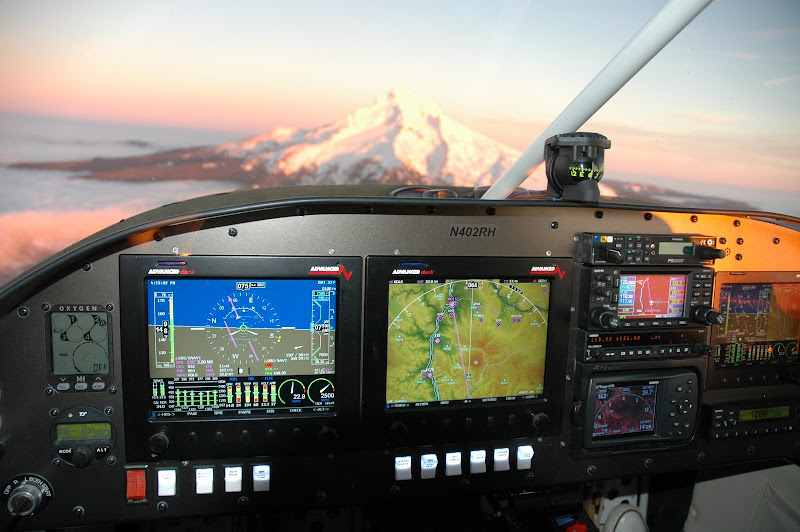

Can you post better pictures of the panel? It looks nice even though it is missing an adequate number of steam gauges.
