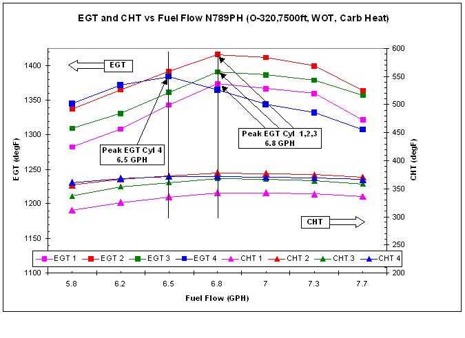

Default It Works!
Actual data from my carbed O-320 with dual EI. Runs cool and efficient. I can get similar results by running with carb heat or by cracking the throttle a bit. My "GAMI spread" is .2-.3 GPH with #4 being the only cyl that does not peak concurrently. I usually settle in at 150KTAS ~6.0 gph and 60-70degF LOP for cruise.

I'm at WOT when using carb heat, so I do lose a bit of the ram pressure. If I don't use carb heat, I need to crack the throttle. On a long XC, I'll try both methods to see which yields the best MPG/speed combo. One usually is a bit better than the other.
It is interesting that I can use the throttle plate to "steer" the fuel towards the front or back cylinders to get a balanced mixture and smoother running. I do this by watching the EGT readouts on the Dynon EMS and varying the throttle position slightly. See if this works on your -4.
