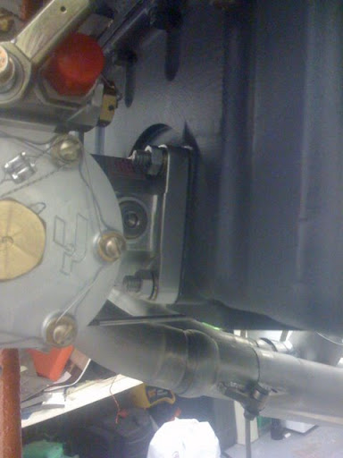

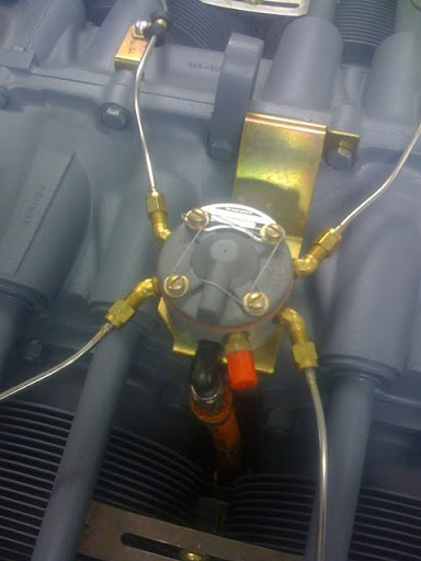

My silverhawk distribution manifold has a NPT-flare port on it. Its the fitting with the red cap on it in the picture below. Since the silverhawk has no purge valve, what does this fitting do? Is it used to sense fuel pressure? My factory direct Lycoming engine came with this FI system but they do not include any instructions for it.
2nd question, a little off topic. The throttle body has four 5/16th nuts that secure it to the sump. Do these nuts require the star-type lock washer to be used on them? Torque should be 110 - 150 "/#'s? I have no instructions on this so your advise is very helpfull.

Picture 1, red cap is at head pressure for the spider. Fuel Pressure could be had from here. Its not for the purge valve. If not used, remove that fitting and put in a plug.
Picture 2, yes a lock washer, star or split, should be used there.
