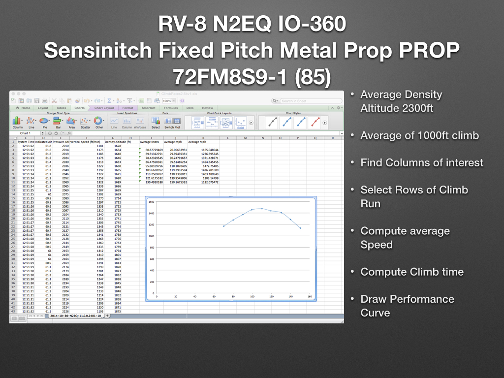

Here what I got with my RV-8. The pic shows one run. Did multiple of them at different altitude and they all looked similar (large flat spot on top). Note my speeds are in mph.
So I think your measurements are in line ... .
Oliver
p.s. Just noticed a typo in the picture column K is ft/min not Mph... .

The test chart for my 7A looks the same as above between 70 and 110 Kts. Flat.
Glad this thread popped back up. I had done two runs and wanted to do a third but I see it is a waste of time since I will get more of same.
I was trying to find best glide on the descent during the sawtooth but that data was equally flat.
I remain very unsure of best glide speed.

I have seenpretty much the same results in many RV's I have tested. My conclusion is that RV's are not that sensitive to "nailing" the airspeed to get the best performance in climb. They are wonderfully-behaved airplanes, with a very wide envelope, making them very great performers on both ends, and especially on the low end where safety is paramount. I'm sure Van must have realized that when he built the first one, and the rest is history.
I think we all have learned the same thing regarding cooling, too---they all seem to cool better around 120 knots in a climb. And the over the nose visibility is enhanced without a climb penalty.

Look at the curve on post #15, and draw a line from the bottom left corner where the rate of climb and speed are both zero to the point on the curve that gives the highest line, that point on the curve is your best angle of climb. It is for that airplane and that engine/prop and that altitude.
Just from looking at it, it sort of looks like it's at the low-speed end of the curve.
