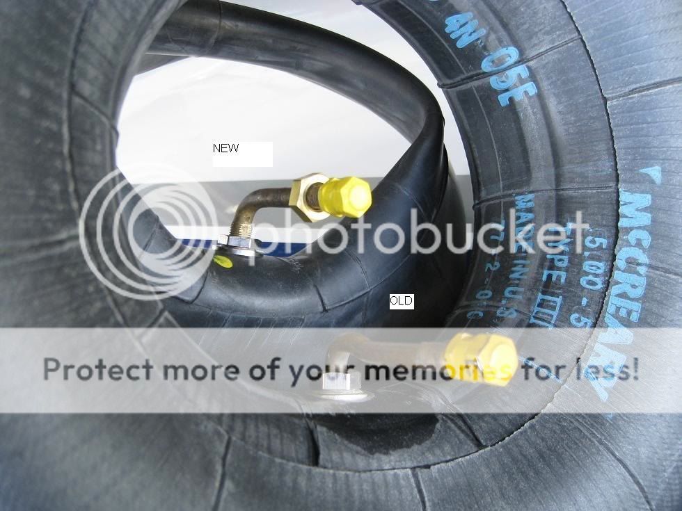

Just tried inserting the valve stem through the hole in the wheel.
The shape of the stem seems to prevent the tube lying snug against the wheel.
There will be a a space between tube and wheel where the stem joins the tube.
Have I got incompatible parts?

Originally Posted by jimgreen View Post
Still looks wrong to me. Tire pressure will stretch the rubber around the valve stem probably leading to premature failure.
Am I the only guy with this problem?
Tire pressure will cause the stem to rotate (lean) to the edge of the rim and make it hard to place a gauge on the stem.
It looks like you have a 6" tube in a 5" rim............

For the archive, here is Van's reply re wrong tube.
"Those are the only tubes we have for the 5.00 x 5s (I presume they are
marked for 5.00x5s?) and they will work OK, if not ideally. When inflated the
tube will force the valve stem towards the wheel rim. We used get tubes with
valve stems with a double bend that avoided this problem, but Desser (the
tube mfr) tell us that those stems are no longer manufactured, and
Cleveland have not moved the hole in the wheel further inboard so it works
better with the available tubes. See attached pic.
Vans"

On the picture from Van's the good tube seems to be the Mc Creacy one, I have sent a mail to Spruce to know if the tube with double bend of the stem still exist.
I don't want to work with 8/32 washers between the tube and wheel or having the stem so that I can't place a gauge on the stem.
Can somebody help us ? Thanks
