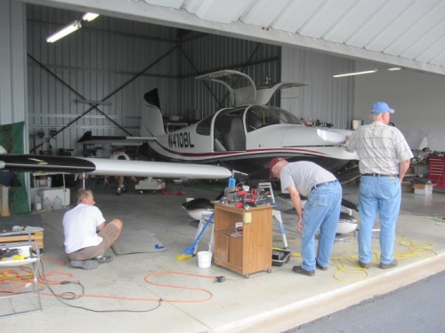

Jay,
If you got a friend with a cnc machine making the part is a piece of cake. Otherwise you can still do it manually, but may not look as nice. Unfortunately, I don't have any good photos online.
Basically, you want to fabricate a cup which slides over the jack piston. This creates a sleeve over the end. This assists in preventing the jack from slipping. Mine comes down about two inches. You want to drill the opening in cup slightly larger than the ram piston. Drill a hole in the bottom of the cup for a round head bolt with the thread size for the tie downs. The round head sits nicely in the indentation of the HF ram head.
If you get a block of aluminum, it should be easy to do with just a drill press. If you have acess to a cnc machine, then you can make the outside nice and round as well.
This one you can barely see it under the wing
This is a good shot of the wing stand
Both of these are taken when I did my W&B. I'll try and remember to take a photo of these when I'm at the hangar later today.
