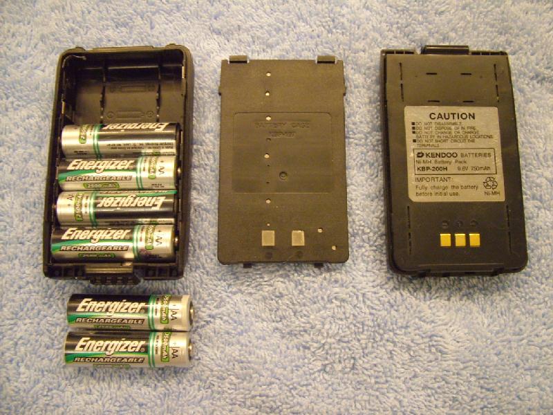

Pete, I am using regular Energizer AA NiMH rechargeable batteries in a case that holds them and inserts similar to the normal battery pack that is recharged through the radio.
If you look at the contacts at the bottom of the case here there are only two. The typical rechargeable battery pack (the whole unit is sealed) has three contacts.
http://tinyurl.com/648cvz
Here is a picture. On the left is the part of the KBP-197 "alkaline" battery case. It holds six AA batteries and in this picture four are installed. To its right is the cover. If you google this unit this number may be better: BABP-197H. Note only two terminals at the bottom. At the far right is the Kendoo KBP-200H battery pack (sealed unit).
I don't doubt that there are better sealed rechargeable battery packs. Some have much more capacity and different battery types may offer advantages. I believe that using these Energizer AA rechargeables (or pick your preferred brand) will be far cheaper in the long run...even short run.
