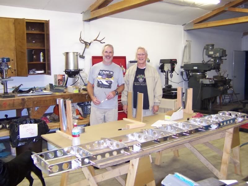

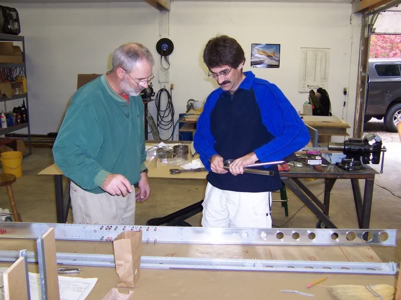

The empennage kit arrived in October of 2005 and we threw ourselves into learning the basics of aluminum fabrication. We were lucky to have Ken Kreuger stop by and show us the basics of riveting, and we practiced his instruction advice throughout the remainder of building. Thanks Ken! Our construction took place in my shop building which is a 36 foot by 48 foot open shop with plenty of tables and space for building an aircraft. The empennage took us until mid December to complete and we were done just in time as the Quick Build kit arrived just before Christmas of 2005. And that?s how we came up with our N number: It?s an RV9 started in 2005 by Andy and Daryl, N905AD ? Get it? OK, so it?s lame, but it works for us!

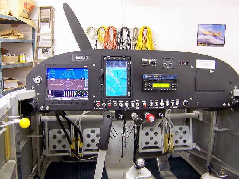

Thus began our work in earnest on the fuselage and much discussion centered on the panel and what should be included and how it should be configured. We quickly zeroed in on this being a VFR only bird with limited night flying capability. And Rob Hickman of Advanced Flight Systems had just come out with their new combined EFIS/EMS system which really appealed to us. The GPS system was a little tougher to decide and we first thought of using a Garmin 396/496 but decided to go with the larger display found in the AvMap EKP-IV. It?s main drawback is the lack of in-flight weather, but they continue to claim that they will offer this option ?soon?. We combined these main items with Van?s standard electrical package, Garmin?s SL-40 comm radio, GTX-327 transponder, PS Engineering intercom, and a Digitrak single axis autopilot. The result is a panel that?s clean and efficient and has everything within easy reach. By deciding on our configuration early on and staying with these choices, we were able to avoid any time delays from changing things as we progressed with our building.
By this time we had fallen into our building routine that would last until we completed the project. During the week we would usually put in a couple of hours of work after dinner (from about 7PM until around 9PM) and work Friday and Sunday afternoons. Our records show that we averaged about 70-75 hours a month of actual building time and totaled about 1750 hours by the time we completed the project.

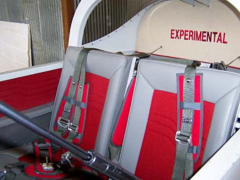

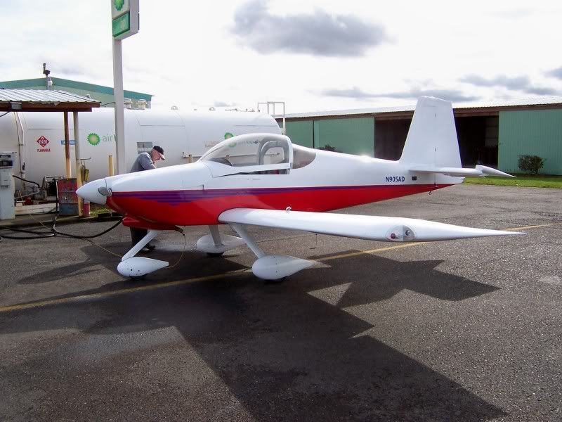

By this time we were nearing completion of the basic airframe which led us to discussions about when to paint the airplane. We talked with a great many people on this subject and everyone seemed to have their own opinion with no real consensus as to what is the best practice. We finally decided that painting the airplane before we took it to the airfield would be the best decision for us. This led to the building of a paint booth in my shop and deciding on who would do the actual painting of the airplane. We were committed to doing the prep work and cleanup work, but neither I nor my partner had any experience at actual painting. Enter a couple of friends, Ken and Frank. They were instrumental in sharing the duties of spraying. The paint scheme was decided on early in our planning process and was based around the paint scheme on the RV-10 220RV at Van?s aircraft but with our choice of colors. The final result is a nice looking aircraft, and although it delayed our first flight, the choice to paint the aircraft before final assembly paid dividends in the long run as we had a ?finished? aircraft at the time of the first flight. A nice paint job and panel, coupled with interior upholstery by Abby of Flightline Interiors resulted in a really nice finished product that gives us the Van?s grin every time we fly it!

When the project was finally completed we had a very competent pilot at the controls on it?s maiden flight. His only comment upon landing was ?no problems, actually boring? which we took as being very good. We now have currently 30 hours on 905AD. Weather permitting we will have our 40 hours flown off very quickly.
