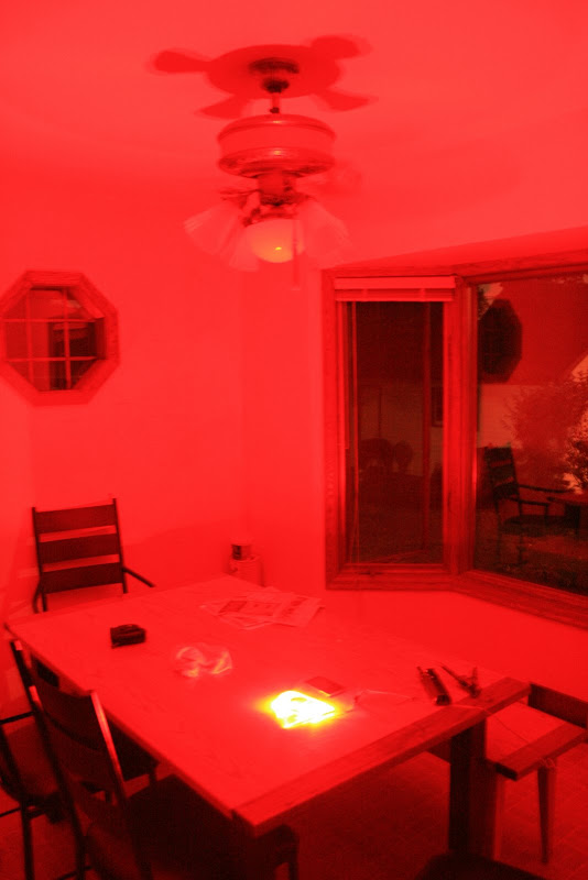

The LuxeonStars LEDs arrived, and we tested them with the the resistor and a 13.something V power supply. Mother of God are those little dudes bright! WOW!
These should make terrific nav lights...thanks for the tip!
I get that a lot when people first see them. It really is amazing.
