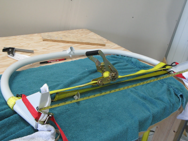

I needed to bend my roll bar a bit to get it to fit. Be prepared with some big nylon come-a-long straps, and a big friend!
Be careful - this makes for a pretty big spring!
