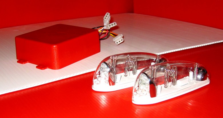

Automotive flasher for the strobe power supply

Default Huh???
Automotive flasher for strobes???
Use something like this SkyBright sytem:
