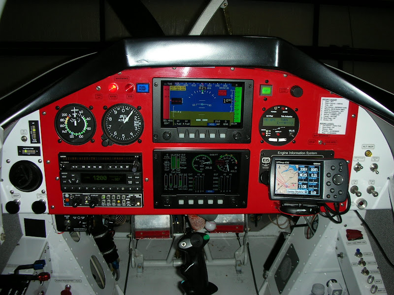

Originally Posted by Webb View Post
Not enough space on the panel so where's the best place to RAC mount a Garmin portable?
I also put mine on an "L" bracket at the bottom right side of the panel. Since it is not flush mounted I can grab the unit with my right hand and operate the buttons with my right thumb as it was designed to be used. The Gizmo mounts look nice, but I would have to install some sort of finger rest to be able to easily use the GPS in turbulence. Also, I use the GPS in other airplanes and it is a snap to take it out. I always remove it to a secure spot when I RON at an unsecure airport.

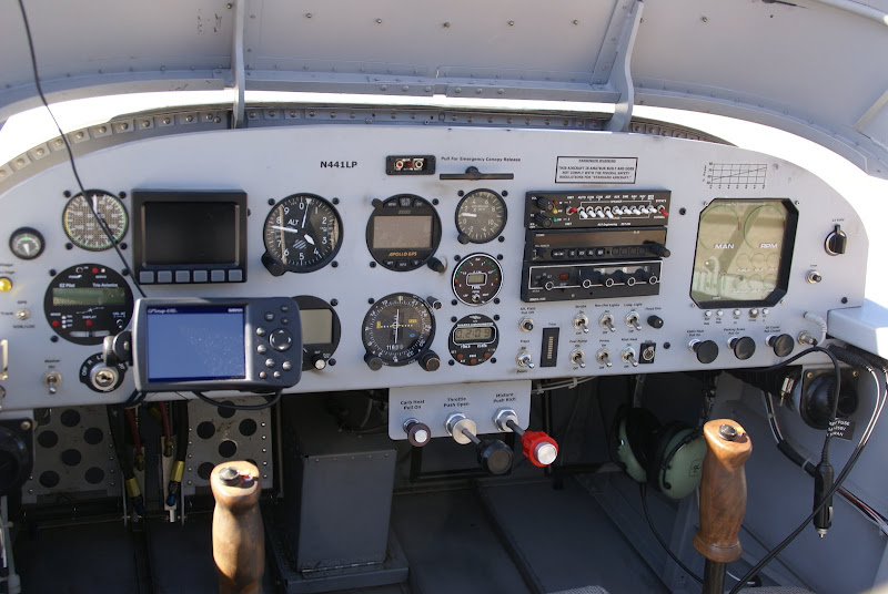

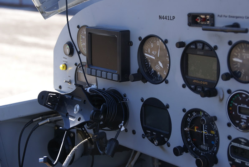

Default Marine Mount
I didn't have room to recess mount my 496 but I did have a spare instrument hole. My panel is a mishmash because of changes over the years. In the dark days of vacuum systems I had an attitude indicator and heading indicator front and center. When I switched to a Dynon, that left an empty hole below it. When I got the Garmin portable I just bolted a Marine Mount to the hole cover. Very simple and it lets you pivot the Garmin left and right and tilt it up and down.
