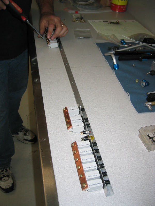

Luke - For an another idea, think about placing the CB's under the panel like this:
This works really well because it puts the bus bar in a nice place for access and neat wire runs. The instrument panel can be removed independently of the CB strip, giving us easy access to everything on the bus. Also its easier for the pilot to see the breakers and labeling (vs placing them in the right side sub panel).
One more pic:
