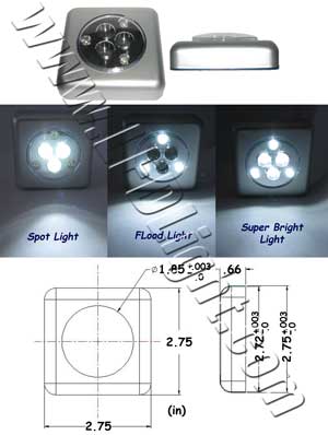

Smile Perhaps a small self-contained....
...LED unit may be better?
Running off it's own AAA cells, it will never make the aircraft battery go dead...
Since you have a tip-up, perhaps you could mount one of these on the roll bar strut?
No wiring involved, and a big investment of around $6 to try it out.
http://www.ledlight.com/easylight-sq...led-light.aspx
