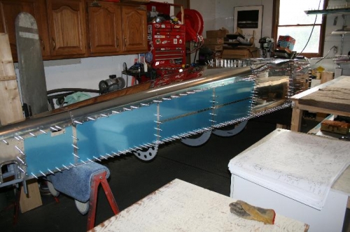

Hi All,
Two week ago I stared building the fuselage. Empenage was like 4 month, wing 9 month. But look what I have in two week!!!!!. Building the fuselage have been the best parts of the project, maybe because now I am seeing that finish my RV-8 is not so far away. Next week Van's is sending me finish Kit, a Lycoming XIO-360 and my hartzell prop
OK my goal is to have the fuselage on the wheels on November, then two month for finish kit and two month for installing everything(avionics, engine, etc).
My wife is pregnant and the baby is coming on March so my plane should be ready, I will need time to change pampers
Wish me luck

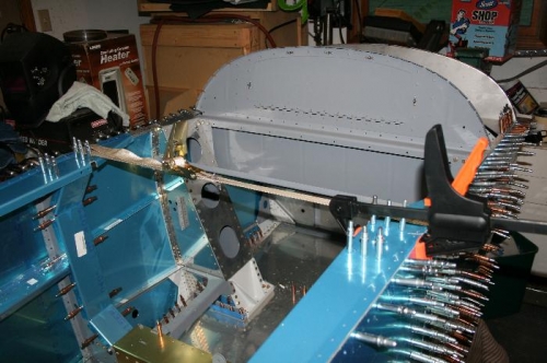

Here's my fuselage upside down in preparation for final riveting.

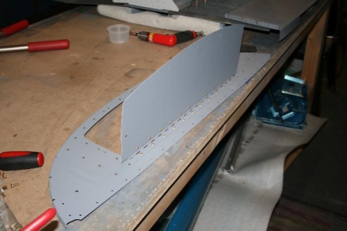

If I were you...... I'd remove the forward cargo compartment's aft bulkhead, and build a access door the opens into the forward cargo compartment. This door will give you access to the rear of the instrument panel. I don't know why Van did not design that into the RV-8, but many of us are glad we did it!

Ditto to what Danny said!!! The mod is easy and you and your back will be very glad to have the access while standing outside the airplane! I left the bottom of the upper skin unprimed just to enhance reflectivity and even considered the utility of installing a simple "service light."

If you don't have at least 500-3/32 and 300-1/8 Clecos, order them now. you are going to need them soon. Ask me how I know.

Here's mine!

Hey Brent, regarding your front baggage access door. You will have to add a tang to the bulkhead to rivet the baggage door support brace to and then notch the access door you made to clear it. It's not a bid deal and I would wait until it's time to mount the brace before I worried with it. Rick Galati has a photo on the home page to give you an idea of what I'm talking about. Looks like your doing a great job, keep pounding.
