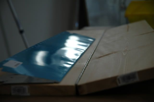

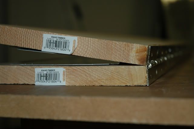

Here is a photo of the skin inside the brake.
Below is the ugly photo, though it's really not as bad as it appears. For this photo, I managed to get the light perfect to show you what I'm talking about.
I couldn't continue bending the skin in the brake because I would have had to over-bend the outer ends of the trim tab just to get the middle section to align with a straight edge. (Remember the middle was springing back and the outside edges weren't.) That's the point when I tried massaging it, but the result looks like *(@#.

I had the same problem. Make sure the boards in the break are perfectly even and parallel. Also increase the spacing between the boards at the hinge to at least equal the bend diameter at the trailing edge (or move the skin back in the break). You might try putting newspaper in the middle of the break to build up a spacing to apply more pressure in the middle of the skin. Obviously you will want to build up the thickness of the spacer (newspaper) gradually so it wouldn't create a crease in the skin.

When I bent my tab for the 9, I used 2x6 lumber (I noticed the photo was 1x6) and put the tab to be bent between the two EDGES of the 2x6, not between the wider sides as shown in the photo in the previous post (you have to modify the position of the hinges as well - I actually just used three old door hinges I had lying around rather than a piano hinge). I also made sure that the edges of the lumber were nice and straight. By using the edges, I had a lot more leverage. One can more easily get that last bit of bend as compared to using the flat sides of the 2x6.
