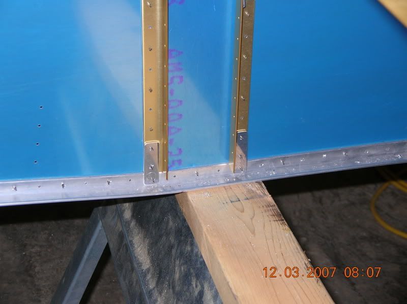

Notice mine are not together here but from here on out, they were...
Make sure you fit the doubler in there as you go!

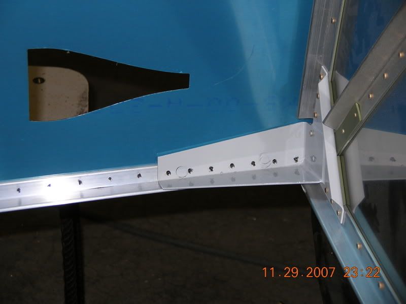

The top of the forward 704 must fit right at the downward bend in the longeron.

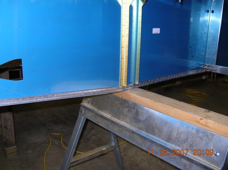

The twist needs to fit these steel parts very well. Easy to do with a cresent wrench.

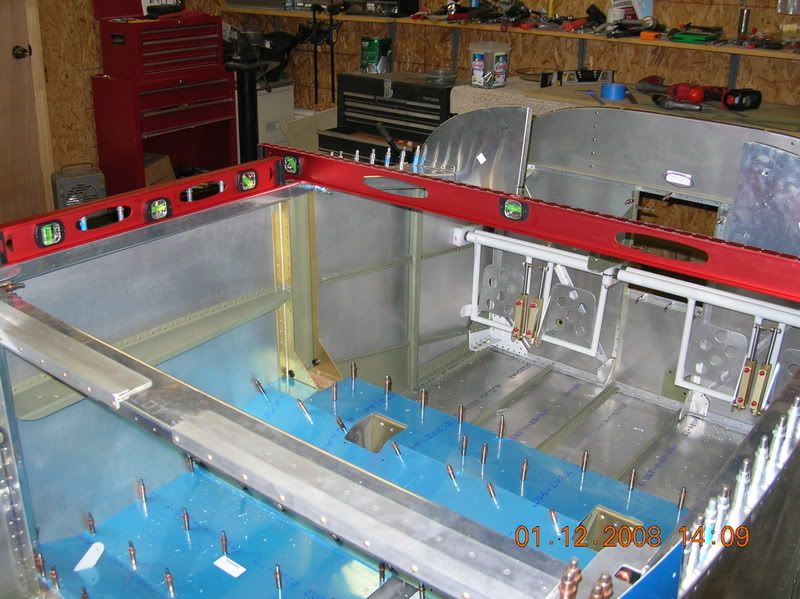

You have to have them together to fit all of this stuff forward (except the brakes and subpanel structure) of the 704 in this pic before final riveting.

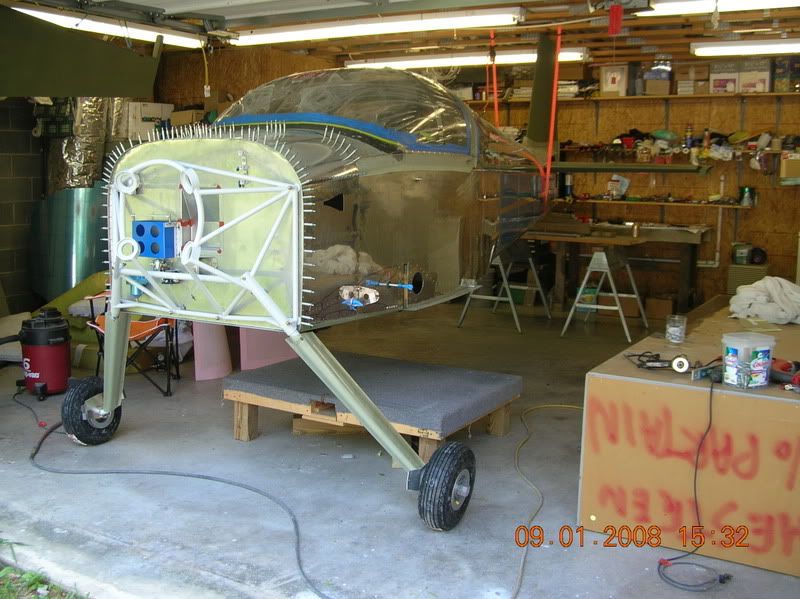

Keep pounding away and before you know it you will have this to deal with :
