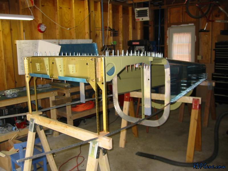

We are near completing the right wing and starting the fuselage. The -8 that we built previously for my buddy was a QB fuselage. My -7A is a standard build (I hate the term "slow" build ). Any suggestions on what sort of jigs/supports/stands we need to make/buy during construction, before there is enough constructed to put up on jackstands or wooden "legs" (or even the actual gear legs)?
Did a search and all I could find were examples of "canoes" or more complete fuses on various stands, rotisseries, etc. We're looking for what we need to have for the early portions of the fuse build.

Steve-
I used three sawhorses:
I hope that helps!
