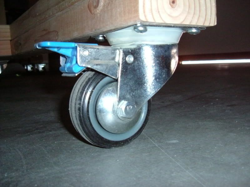

I bought these at Home Depot, and like them so far. They keep the wheel from rolling and turning when locked.
Kelly
