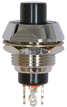

Default photo of PTT
Bill, I think this is the one.
Anybody know why it has 4 tangs to connect wires to on a PTT switch?

Bob
Yep thats the switch that I have, thanks for posting the pic. I couldn't figure out how to do that.
