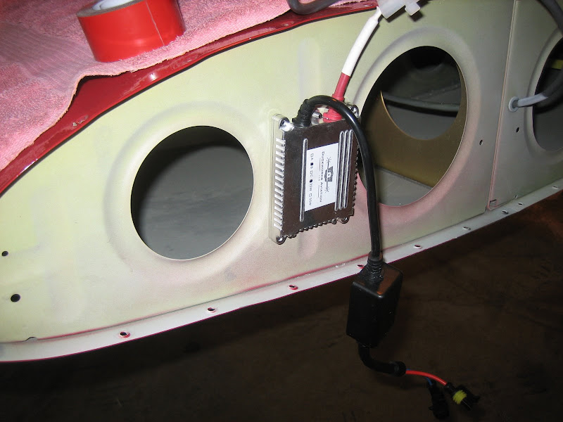

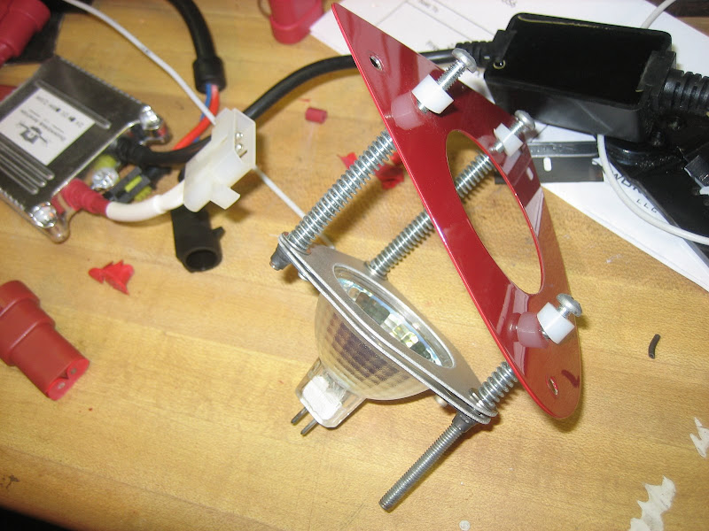

The kits are very simple, and didn't require instructions - the only thing I had to do to prep for installation was to cut off the power input plug (looked like an automotive plug for which I didn't have a "mate" and install a nylon connector from my shop supply. Then it was on to removing the wingtips. To make a long story short, there were no surprises - I started removing the tip at about 2030 last night, had the first one installed and re-assembled in an hour, and took half that time on the second one. I opened up the hangar doors, connected some ground power to the airplane so I could do some aiming without worrying about running down the battery, and voil?' !! Instant sun!

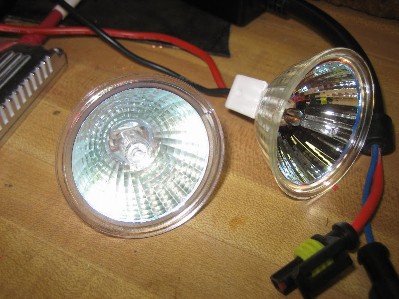

Light measurements are very tricky, so I'll give an unscientific estimate that these things have GOBS more light than the halogens. I was able to light up my ramp, the runway, and the backyard of the neighbor across the runway from me. Aiming was a matter of trying not to blind myself with reflected light while trying to make adjustments. I aim one for tail-high (Landing), and one for tail-low (taxi).
I have heard and read concern over the effects of RFI on wing tip antennas, so on today's breakfast run, I played with the lights and both the Nav (in my right wing tip) and the #2 Comm (in my left. Yes, you can hear the lights on the Comm. But that antenna is marginal anyway (only good for about 30 miles), and I have been thinking about putting a second belly antenna on - I paid enough for th radio, it's silly not to have a good antenna! the Nav locked up on stations at normal ranges, regardless of the light being on or off.

Comparison of the Halogen (left) and HID (right) lamps:

Ballast installed on the outboard rib with three screws - took minutes!
The HID Lamp fits right into the Creativeair holder (this is the Halogen bulb):
