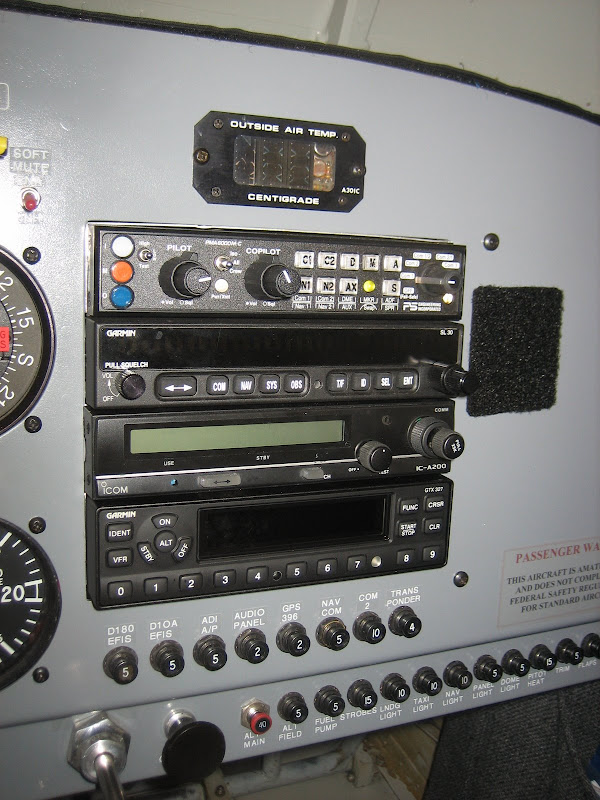

It is highly unusual when ANYTHING that we do on a homebuilt goes exactly according to plan, so I am a Little hesitant to say that this job is actually finished - but the installation went well, and the transponder is apparently working fine!
Here is Mikey's "final" stack:
A few notes:
1) The outside dimension (width) of the GTX 327 tray is slightly winder than the other trays in the panel, so I had to do a little bit of filing to make the slot wider so tat it would fit. The slot is edged with 3/4" aluminum angel, which meant I had a bit more material to remove, but it only took about 30 minutes to have the tray mounted nice and snug.
2) Power, Ground, and lighting were all I needed - plus a serial line for the altitude data, and the antenna. While the installation manual shows a right angle BNC connector (to which you solder the antenna wire) on the drawings, what was really there was a BNC bulkhead connector, so all I had to do was put a standard BNC male on the end of the existing cable, and it mated right up. Much nicer!
3) I took the altitude data off of the Dynon D10A, and low and behold, I had actually tucked the serial "out" wire that was installed in the harness connector into the wire bundles for safe keeping when we id the original install. It was a simple matter to find the end and splice it to th wire I ran out of the transponder rack. It worked the first time when power was applied!
4) I really like the GTX 327 because it displays the altitude it is getting from the encoder, so you know right away if it is working or not. A quick trip around the patch in the evening with a call to Houston Approach for a Mode C check confirmed the installation works. We'll finish up the IFR cert this week, but at least I now know it works!
5) It is really great to have a company like Steinair at our call when you need something in a hurry. They are homebuilders themselves and understand when things need to be a rush job, and when they don't - a real big advantage over the "big box" aviation stores who's employees might or might not fly, much less own airplanes!
While I certainly didn't expect the sudden expense of a transponder, and didn't really have anything against th old AT50A, it does feel mighty good to get that old beast and it's ancient encoder out of the panel - the last of the old stuff to go!
