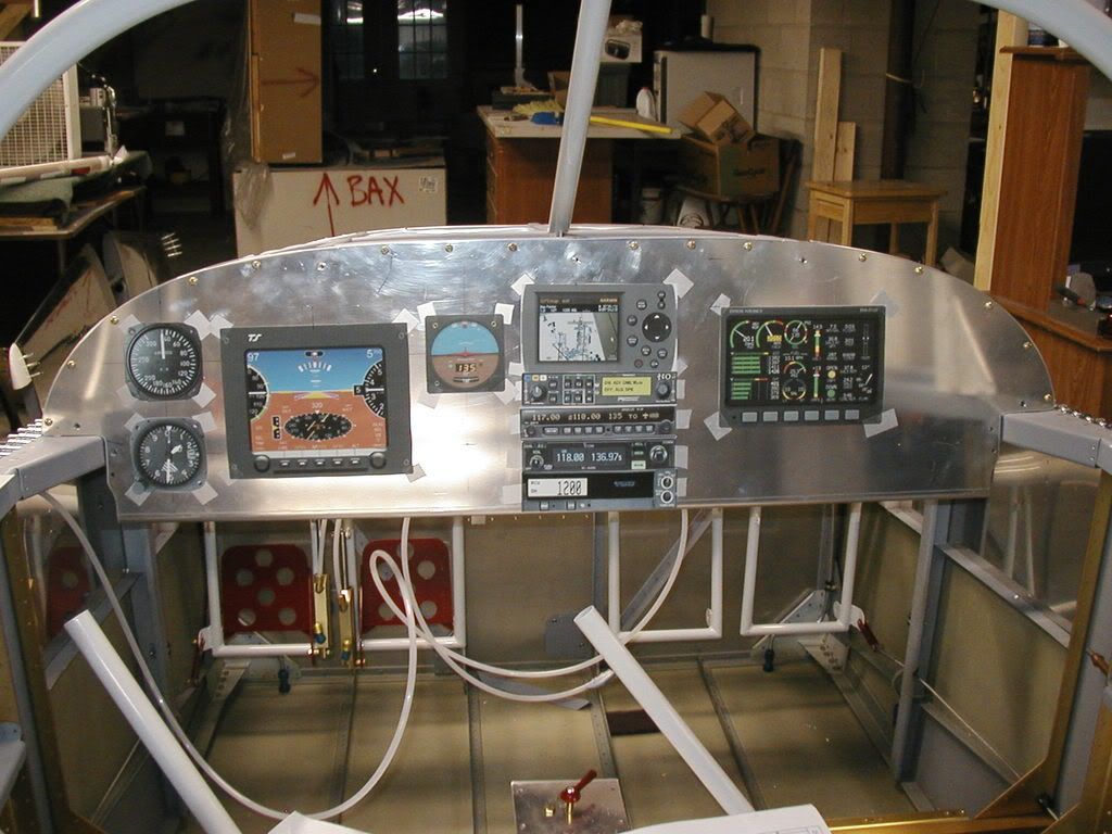

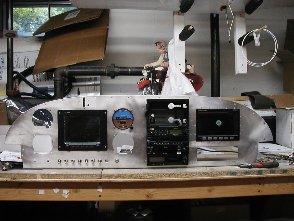

This is kinda what I had in mind when I started. I posted it on the -7 forum, but it didn't attract a lot of interest. When I posted it I had all the gear in house already. I actually put a lot of thought and deliberation into what I bought, some choices were made by desire, some by $$$$$$. The layout is what works for me, mostly by my experiences in the planes I've flown in my 500 hrs. and what I think I want. I spent a lot of time looking at all the panel pics. Boy there sure are a lot of different ones, probably 5000 + The mock up was very helpful when sitting in the plane. Everything is well within reach and easily readable. Cockpits are really pretty cozy after all.
Well I went off to work Saturday morning and set my panel blank up on our CNC milling center. I had to set it up twice, becuase the travel across the table was only 30". Took me about 3 hours, as I really took my time, didn't want to make a bad cut. It came out great!! It really was/is a bigger part of the project than I had envisioned at first. Drawing up the design in Mastercam took me sometime, with a lot of rearranging and fine tuning placement of stuff. One thing I didn't realize right away is that Van's .dwg file has the extra 1" along the bottom, the piece that's bent back.
After I got the initial brackets mounted, I installed the trays and popped everything in for a quick look. I'm rather happy with it so far. One of the best parts of building the plane is envisioning what I want in my mind, and then being able to create it.
It's kinda hard to make it out in the pic, but the equipment is a TruTrak EFIS, TT pictoral pilot auto pilot. The radio stack is the air gizmo for a 495/496, PS Enginnering 9000ex, Garmin SL30, ICOM A210, and a Narco AT165 tx. The engine monitoring will be the Dynon EMS 120. There's still a couple of small holes I'll have to put in, but the machine was sitting there between jobs on a Saturday.
