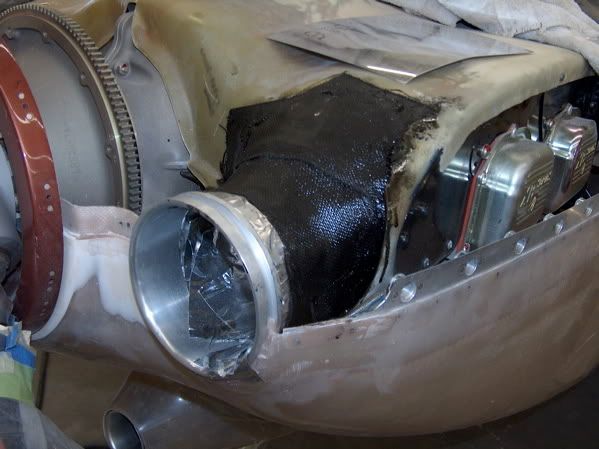

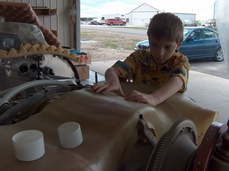

Basically it is about trimming the baffling down so the plenum sits nice and low in the engine, then tying it down, and making airtight connections to the inlet rings. My example is likely different than yours because I adapted a James angle valve plenum to a straight valve engine. First I cut the plenum down so it fit inside the plenum:
Then I marked the baffling and timmed the baffling down:
Then we fiberglass a lip that went over the baffling and drilled holes through both that lip and the baffling with nutplates on the inside side of the baffling for mounting screws.
I ended up needing to build in a bulge for the fuel divider on the top of the engine.
Now I am finalizing the connection to the inlet rings.
I have more pictures in threads here and here.
Reminder: James uses polyester based resin, not epoxy. Old school!
I hope that helps,
