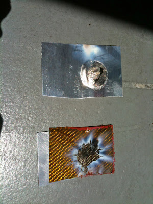

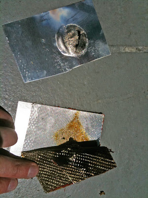

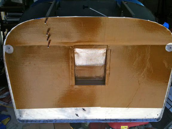

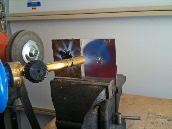

I searched for a lightweight firewall foreward material similar to Kool Mat and came across a new product from the same company called Motor Armor. I am not an engineer and cant endorse the product beyond my personal experience but here is what I found.
I know a stainless steel firewall doesn't need any protecting but I wanted to add another layer for sound and heat dampening without the weight of cool mat. I know Without the weight it wont dampen nearly as much as kool mat.
The Motor Armor is a carbon fiber based product that has pressure adhesive included and is made for firewall forward use.
An amatuer flame test had the following results. I put a torch against the motor armor attached to thin aluminum and unprotected aluminum for 3 minutes. I didnt pick 3 min for any particular reason. The motor armor charred but didnt burn through and didnt sustain a flame.
I need some more material for the bottom portion. Looks cool except where it wrinkled on me.
