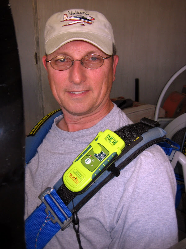

Paul,
Do you have a picture or commentary on how you mounted your PLB on the shoulder harness? I have the same unit and have been looking at how to utilize the clip/bracket that it comes with, but it is escaping me.

A pack of Velcro straps and a 2"wide strap (with buckle) off of an old back-pack, all strapped around my shoulder harness pad. It was a temporary, "trial fit" that just ended up as the on-going solution....

So how did the Crow 5 point work in your -8? I want to upgrade my -8 to better harnesses and want a second opinion! Not sure how "Bubbaesque" you are, but did the "Bubba Factor" cause the latch to interfere with the stick?
Paul - it would still be nice to see a picture of your PLB mount.

I thought I'd posted this before - very simple. I have some harness pads from Schroth that zip over my Crow's. I simply passed an old backpack strap through it and buckled it in line with the pad, and holding the PLB bracket. Used a couple of Velcro cable keepers around the pad to keep it tight and centered. Nothing is permanently attached - easy as pie!
