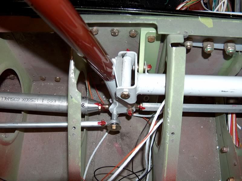

Here is a good picture of the controls installed in my -9.
As you can see, no modifications were needed to get full stick travel. With the controls installed, the stick doesn't hit anything. W/O them installed, there may be some issues.
Check your plans, is it possible you have a rib in backwards or some such issue?

Rob,
You are correct, I did have to trim mine. It has been a long time since I made that section.
You can see better details of the cutouts in this picture:
