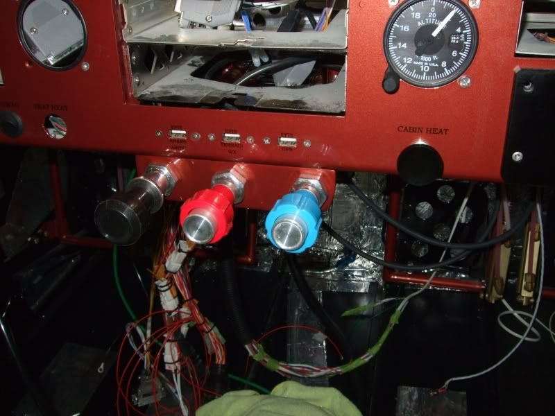

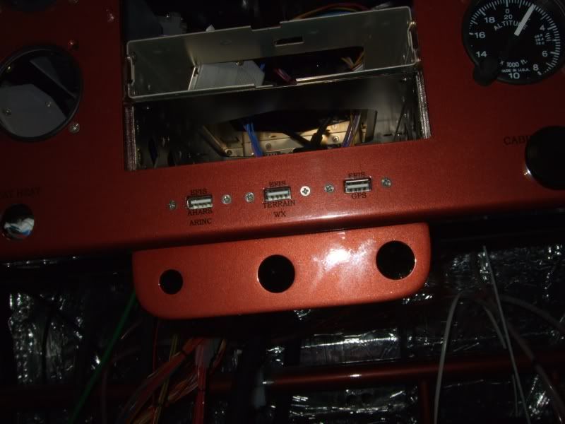

The cables from Van's that I just installed:
Throttle: 1/2 inch hole
Prop and Mixture: 3/4 inch hole
Make sure to leave enough space for the nut AND lock washer. One of my holes was too close, but I made it work anyway. Here are some pictures.
Dr. Hans Conser
Bozeman Chiropractor
RV-6A 195 Hours, up for sale soon?

Why did you not go throttle-prop-mixture order?

WOW, Thats purty!
How did you make those curves?
