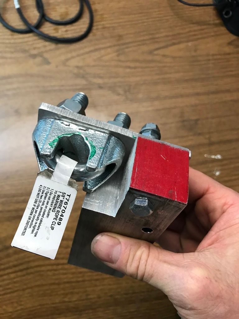

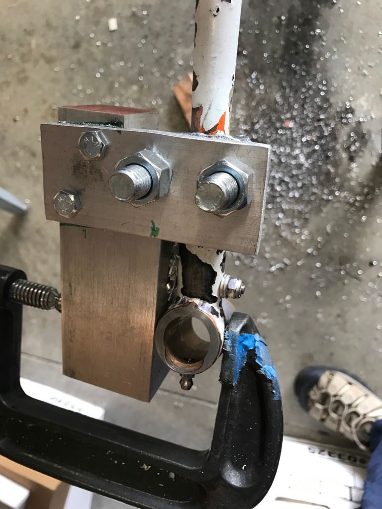

Another one
Here is my drill guide. The c-clamp sets the vertical angle of the block of aluminum. The two large nuts are part of a large cable clamp that clamps firmly to the tailwheel spring to prevent any movement. You may notice there is one bolt through the tailwheel socket. This was to guarantee it was held in position when I drilled the guide holes in the large aluminum block. Also I had to cut a notch out of the corner of the aluminum block to clear the cable clamp.
