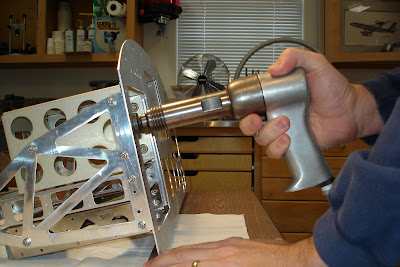

Tom,
The reason the rivet set bounced a bit on the head of your rivets could be because you're holding the rivet gun wrong. The following technique was shown to me by a couple aviation sheet metal guys each with 30+ years experience...
I'm holding my Chicago Pneumatic 4x Longstroke gun. Note the trigger is under my *middle* finger, not my index finger. This hand placement helps align the bucking action of the gun with the center of my hand and in line with my arm. This is important to get right, especially with a hard hitting 4x gun.
Triggering the gun (intuitively) with your index finger places the gun higher up in your hand and makes it harder to handle the bucking action of the gun. This, in turn, can allow the rivet set to bounce off the work.
One more thing to notice: I've got my ring finger under the trigger which helps to prevent over-throttling the gun and gives you a better touch on the trigger.
Try it - it'll take just a little time to get used to but you'll never again go back to holding the gun the old way (if you ever did). By the way, this is also a very good way to hold a drill.
How to hold a rivet gun
One last tip: I turn the pressure down to about 40psi for 3/32 rivets and up to about 60psi for 1/8 rivets with this gun. The 4x longstroke is a hard hitter, but it also cycles slower than a 3x and is heavier in your hand. I prefer it over the 3x guns for the control it gives, esp when throttled with less air pressure. Good luck!
