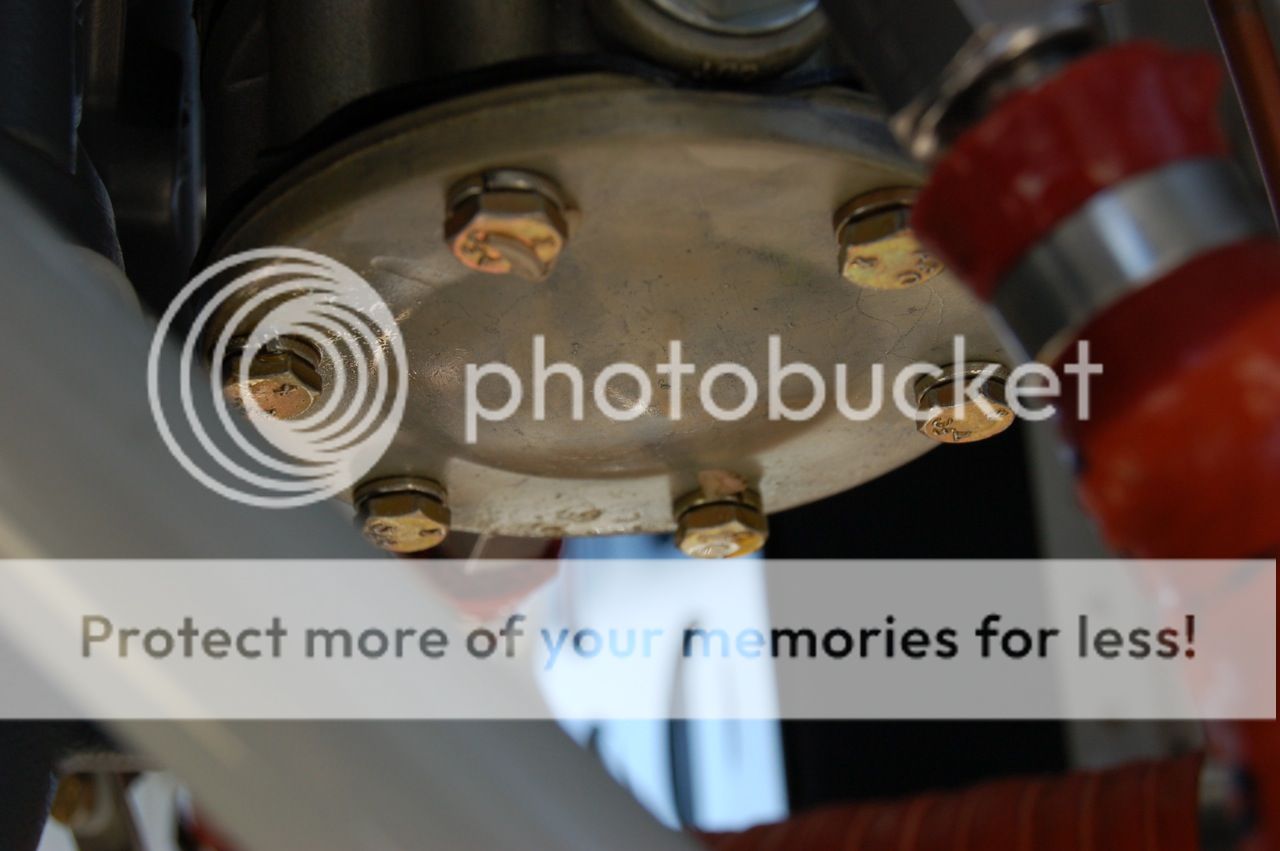

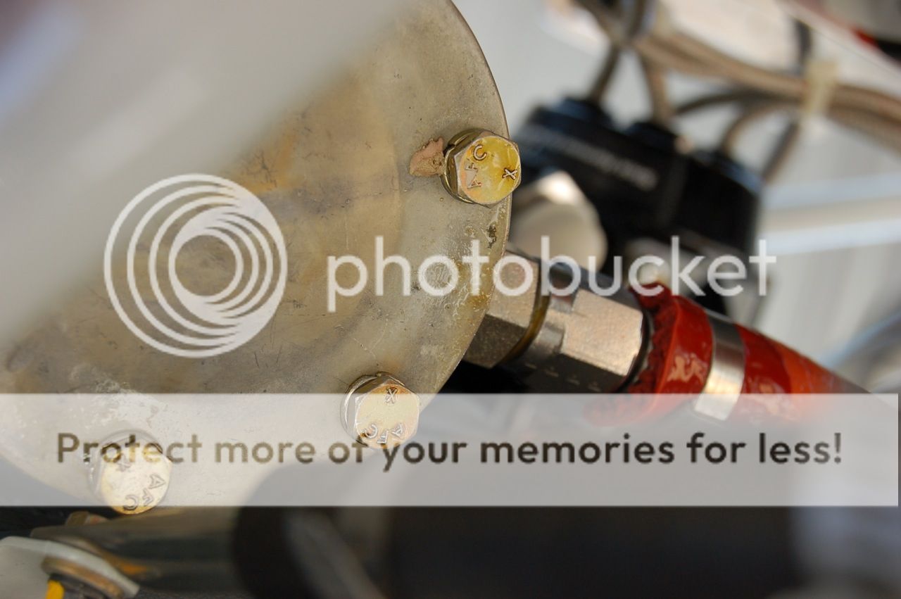

Have RV-7 with Mattituck O-360 Carburated. Went to change oil yesterday and found fuel spot under cowling. De-cowled and found fuel leaking from E.D. Fuel Pump. Discovered all six 1 1/2" bolts holding the diaphram up onto the pump were finger (not)tight with fuel leaking out of the circumference. Tightened all six with screw-driver & of course stripped one of them. (Very soft metal). Called Mattituck and was told that was the first problem they have had with same. No other problems in 340 hours of heavy flying. Don't know if vibration backed them off or they were that way from the start. Suggest you check yours ASAP. Might save a walk back to the hangar.

Is there safety wire holes in the screws? I have not looked at it, but it seems to me this would be a good place for safety wire & loctite.

No, on the penn motor it had the spring circle under the screws.

Just received new pump from Mattituck that has lock washers under all six bolts with torque seal on two of them. OLD ONE HAD NOTHING ON THEM ! ! ! -------Must have been made in CHINA !!!!!!!!!!!!!!!!

Have RV-7 with Mattituck O-360 Carburated also. I have about 550 hours on the engine and recently noticed my engine monitor warning of low fuel pressure. I checked the fuel pump and found the bottom screws almost less than finger tight. Tightened all to 25 in.lbs. and at engine run the fuel pressure was 8 psi ( a bit high but it was ok with me at the time.)
After another 8-9 hours of flying, at take off without the auxiliary fuel pump on, the engine stumbled making less that full power. Carb heat did not clear it but applying auxiliary fuel pump did restore full power and pressure to 6 psi. Now without auxiliary pump power on, fuel pressure is less than 1 and falls below my expectation of 4-6 psi. I have filed, as suggested by Russell Mahlon of Mattituck, the Malfunction and Defect Report with the FAA.
My engine was built about 10 years ago and I will order and install a new Tempest pump in a few days. Over the years of good engine performance, I admit I became complacent and did not check closely the condition of the fuel pump screws at annual. As my experience tells, the fuel pump is important so I am putting that check of the screws on my annual condition check list.

Wouldn't it be even better to get bolts with holes through the heads and safety them?
