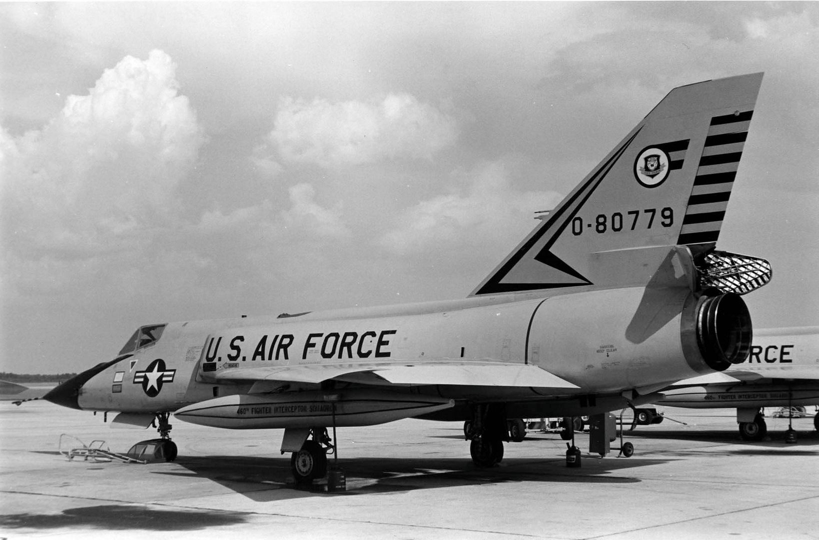

It's phrases like the one above that remind me of how often I like to tinker with things that aren't broken.
But seriously, if a FP prop RV wanted to add some yaw stability, sink rate, slow an approach or shorten landing distance, would a speed brake like this...
...installed under the horizontal stabilizer on the right and left side be feasable? Nothing too big, maybe 8 inches tall and 4-6 inches wide and hinged on the leading edge? Would that destroy the rudder effectiveness? Is there room with all the other control linkages? Is this something that could be accomplished with a lever and a closed cable loop?

Problem solved!

A good friend flew B-47's and stated the reason for the chute was to create enough drag to allow the engines to be kept spooled up. He said that the time to spool those engines up was in the 15-20second range Think about what go-arounds must have been like.

A split rudder maybe? Space Shuttle style.
What happened for subsequent landing attempts in the B-47? Was the chute able to be reeled in?
